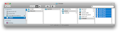

If your video editing software is able to import .MTS clips directly then just copy the STREAM folder on your SDHC card to your computer and rename the folder. Give it an unique name (e.g. event_date). Then you can burn up to half an hour of AVCHD clip folders on a DVD-ROM or up to one hour on a double-sided one and store it away.

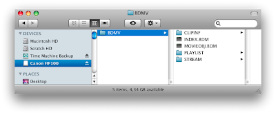

iMovie 08 and Final Cut Express 4 don't import .MTS files directly. They import from a supported camcorder, the SDHC card, a mounted disk image or a DVD-ROM. In order to be able to re-import the HF100 clips you must backup the entire BDMV folder of each card. This folder contains the STREAM folder as well as thumbnail and clip info folders that are needed by the import window. To backup the videos on a SDHC card just copy the BDMV folder to an unique named folder on your computer.

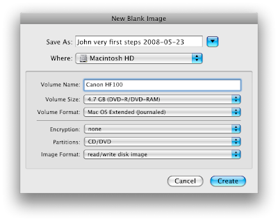

The second possibility is to use a disk image. Open Disk Utility and go to File > New > New Blank Image... Choose a volume size thats large enough for your BDMV folder and click OK.

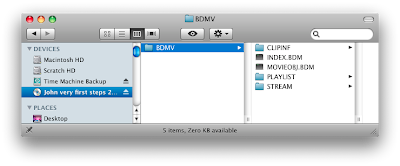

Copy the BDMV folder to the mounted disk image and start iMovie 08. iMovie 08 will recognize a disk image as shown below and automatically open its AVCHD import window. You can also archive such disk images.
